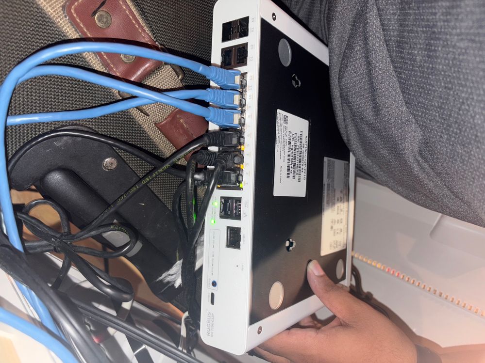

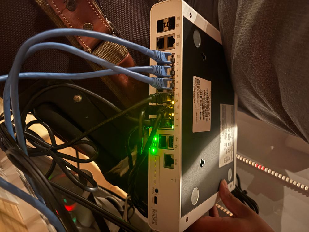

Recently my APs stopped working. I have a green power and system light on the switch (7150). I also have a green light on the port with the data coming in. No lights on the ports where my APs are plugged in. I have power cycled the switch several times, the APs work temporarily sometimes and then go dark again.
Hard reset in the switch is not working.
Please help

2)  Please refer to the below picture and share a picture of the same, showing the light status and the FULL Switch panel cable connections to the Switch ports)

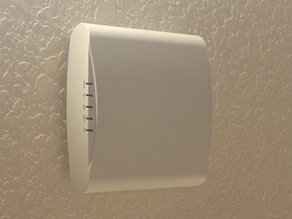

3)   May I know how many Access Points are connected to the Switch? Could you please let me know the light status on the Access Points? Any of these lights are on (Please refer to the below picture and share a picture of the same)

Hello and thank you very much. To answer your questions, there was no power outage from what I remember before this happened. There are 3 APs each on separate floors. I have attached pictures of the switch and the basement AP. The other APs have no lights on just like the basement. I also noticed that the Ethernet ports for the AP connections are not lighting up at all like the other Ethernet ports, so I tried to use a separate one, but that did not change anything, and the lights on the port still did not turn on. IMG_1836.jpgIMG_1837.jpgIMG_1838.jpg
