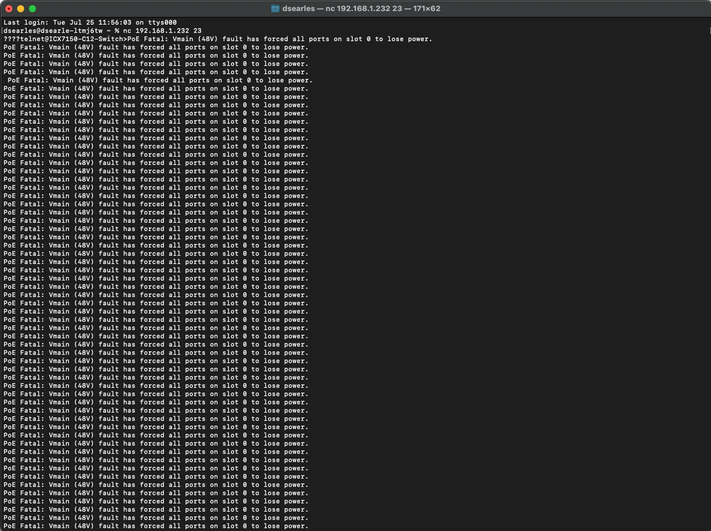

I started that process and when I was on step 17 - I started to get this

Hi @delaneysearles
Please try upgrading with the TFTP CLI or Web options.

I also went back into the terminal, and when I enter the same command as before ( nc 192.168.1.232 23) - it is still saying the same error
