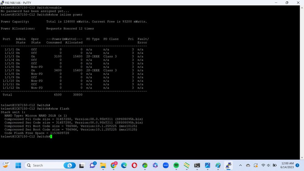

Hi @RMontes925
Thank you for the update.
After performing the commands, we shared in the last post should work for the issue you had.
As you can see from the below screenshot, your APs took time to power on due to a voltage issue. This is due to a voltage issue and is not related to any device.
And when the voltage is stable your Access Points were able to get the power as we can see from the other screenshot you shared.
