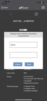

I have one ICX7150 and two R510 AP .
ICX7150 - FW Version:09.0.10dT211 (SPS09010d.bin)
R510 - FW version:  200.13.6.1.319
R510 can't connect to the ICX switch and shows "ICX Switch is Connecting". It used to work with the old FW release, what is going on ? SSH is enabled, I can manually SSH to the Switch or AP

ohabib
Hi Vásquez_Fer
no luck, I tried to remove the user accounts and recreate new ones for the switch. I also removed the switch from the unleashed and manually added it by Ip/user/password
it does not move from connecting state. It asked me to enter credentials for the switch .. I did and it stays connecting
is there any other relative settings in the unleashes or switch side to control the authentication ?
