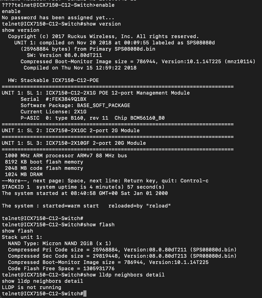

12-04-2023 02:50 PM - edited 12-04-2023 02:51 PM
????telnet@ICX7150-C12-Switch>enable
telnet@ICX7150-C12-Switch#show version
show version
Copyright (c) 2017 Ruckus Wireless, Inc. All rights reserved.
UNIT 1: compiled on Nov 20 2018 at 00:09:55 labeled as SPS08080d
(25968884 bytes) from Primary SPS08080d.bin
SW: Version 08.0.80dT211
Compressed Boot-Monitor Image size = 786944, Version:10.1.14T225 (mnz10114)
Compiled on Thu Nov 15 12:59:22 2018
HW: Stackable ICX7150-C12-POE
Serial #:FEK3849Q1BX
Software Package: BASE_SOFT_PACKAGE
Current License: 2X1G
8192 KB boot flash memory
2048 MB code flash memory
1024 MB DRAM
--More--, next page: Space, next line: Return key, quit: Control-c
STACKID 1 system uptime is 22 minute(s) 14 second(s)
The system started at 04:39:18 GMT+00 Sat Jan 01 2000
The system : started=warm start reloaded=by "reload"
telnet@ICX7150-C12-Switch#show flash
show flash
Stack unit 1:
Compressed Pri Code size = 25968884, Version:08.0.80dT211 (SPS08080d.bin)
Compressed Sec Code size = 29819448, Version:08.0.80dT213 (SPR08080d.bin)
Code Flash Free Space = 1305993216
telnet@ICX7150-C12-Switch#show lldp neighbors detail
LLDP is not running

Unable to paste results to query above
12-04-2023 06:34 PM
I have attached an image instead
