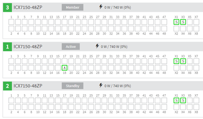

Is there a way to change the display order for stacked switches? I just created my first stack, and for some reason the units are displayed top to bottom 3 (Member), 1 (Active), 2 (Standby). This could obviously get confusing in the future if the switches aren't mounted in this order in the rack.

But this order isn't reflected in the Ruckus Cloud interface:
NathanJ
Found it. There is a Rearrange Members option at the top when a stack is selected.
