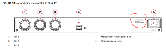

06-09-2023 10:05 AM - edited 06-09-2023 10:06 AM
Hi Wpfleeger
Thank you for reverting.
From the pic attached below the 7150s do have a note on the back of the switch saying ‘AC Input Rating 100v to 240v’ (as below for a 7150-48PF). The hardware installation guide has this information as well.
I hope this helps answer your question.
