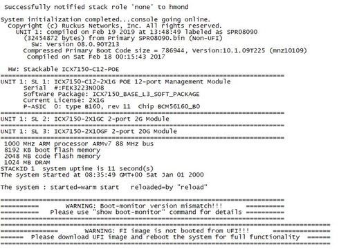

I uploaded image successfully. But another problem as attached picture. Could you help me have a look itImage_ images_messages_5f91c47d135b77e247ab7c96_314a7ff9d1fe86c57a941ee60116ae45_RackMultipart201909186839913s7-691eed10-f060-4db1-af64-65559c307ce5-520278798.JPG1568802730
Hi Thanh - Upgrading to 8090 is a two-step process. Please copy 8090ufi image to flash and reload 1 more time.  Please see more details in the upgrade guide here:
