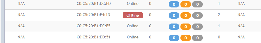

hi Ben,
still have an issue on icx 7150-08P.... they can register to SZ100 but they are not showing any info.... but for 24 and 48 are working normally. please do you have any idea on this?
