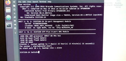

Are you doing L2 Multicast ( Igmp snooping) or L3 Multicast (PIM, IGMP/MLD) ?
Please post 'show version' o/p from the switch here.

We are doing plane multicast. Since the data has to go through a data diode, IGMP snooping needs to be disabled. I will check on the version.

Image_ images_messages_5f91c455135b77e247a2e587_f5ac2fcd07a1d36c9b10f5cfb3f37129_RackMultipart2019112668674b3tj-a17520ff-cc7e-4e80-85eb-e471ed2fff06-236369002.jpg1574791289

Hi Sven,
Pls upgrade to 8070g and redo the test.
