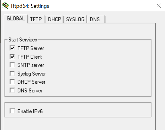

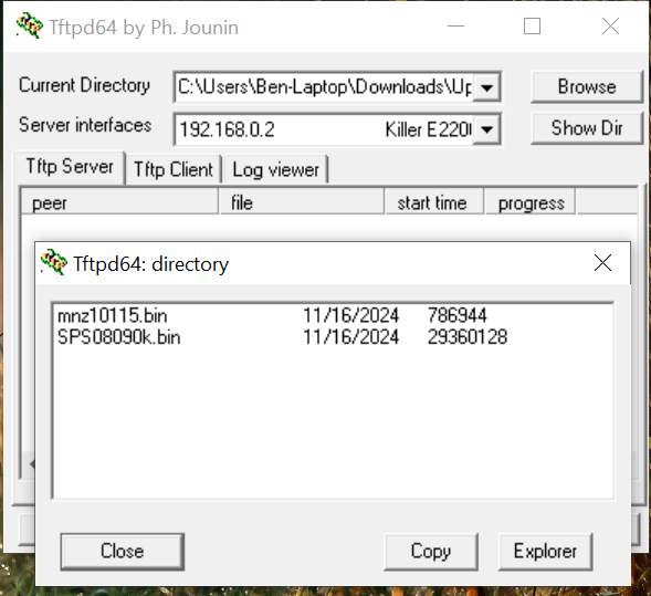

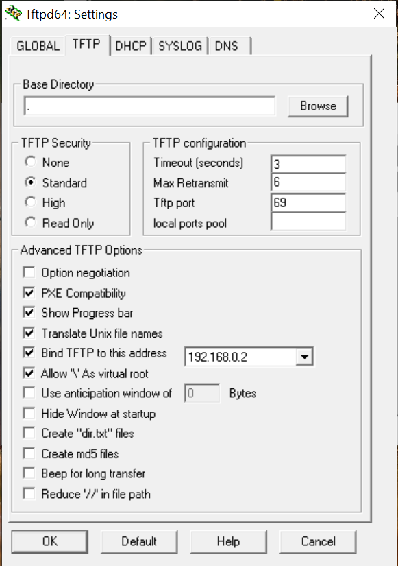

Hello, my ICX 7150 is stuck in Recovery Mode, and I am trying to update the images via TFTP. I followed the post below, and I was able to ping the host. However, I was stuck in the final step when updating the image. How to perform a Software recovery on an ICX7150 switch
I have a feeling it's the TFTP server's problem, but I am unsure what's wrong.
Any advises, comments, and ideas are appreciated.
Thank you!

11-18-2024 03:06 AM
Hi SuperXBen,
Based on the error encountered :
Loading: T T T T T T T T T T
Retry count exceeded; starting again
Here the concern is that the switch is not getting an response from the server.
Settings on the server application should be good.
Do check once if the System Firewall is hindering it or if the system is governed by AD Group policy, try checking with a system that is a non-domain PC where the settings for the firewall an other rules could be manipulated.
That should help.
Let us know how that goes.
