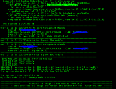

@BenBeck Thanks for your response. Regarding Non-UFI, I have on another location also 2 Ruckus ICX 7250, they are also stacked and firmware on them is SPR08090mc.bin (Non-UFI). There is screenshot of CLI:
Also there screenshot of downloaded files, you can find UFI and Non-UFI firmware's:
Or I have understood incorrectly?

Yes, you can go directly from 08030 to 08090mc non-ufi by flashing both bootrom & images.
