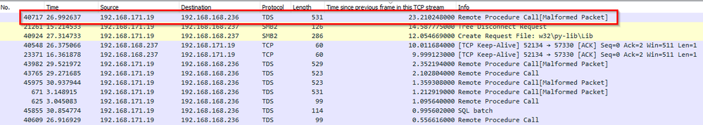

Here are some outputs of whiresharks. I sorted the whole whireshark so you can see what takes the longest to process. Just to give you an image. We start CSB and then open the GPM editor (to edit labels) and that takes normally around 6 seconds to open.
This output is done on our old HP switches:
You can see that the TDS protocol is taking around 4.5 seconds to process

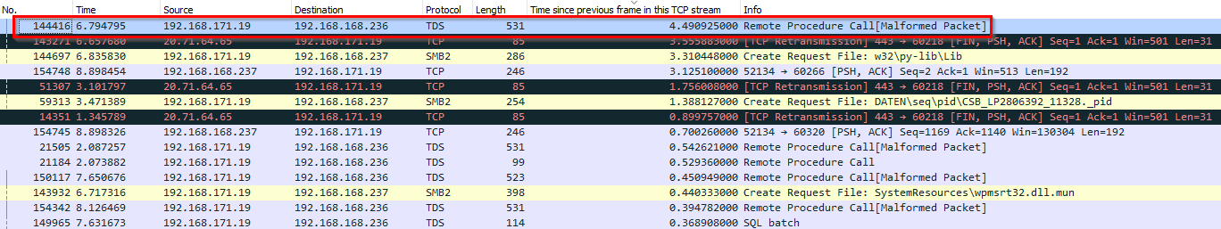

This is the output done on our new Ruckus 8200 switches:
You can clearly see that the same process is taking 5-6 times longer than usual. This has effect on all things done in CSB.
As a test we received a Ruckus 7150 switch. We connected the switch the same way as the 8200 switches in our network. When connected to a 7150 switch all problems are resolved. All setups as mentioned above have good performance. The GPM editor opens in around 6 seconds. The configuration of the 7150 and the 8200 are the same which is pretty basic.
So from all testing we think the issue sits with our 8200 switches. We have already done updates to the RDR10010b firmware. But that does not resolve the issue.
