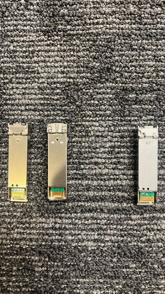

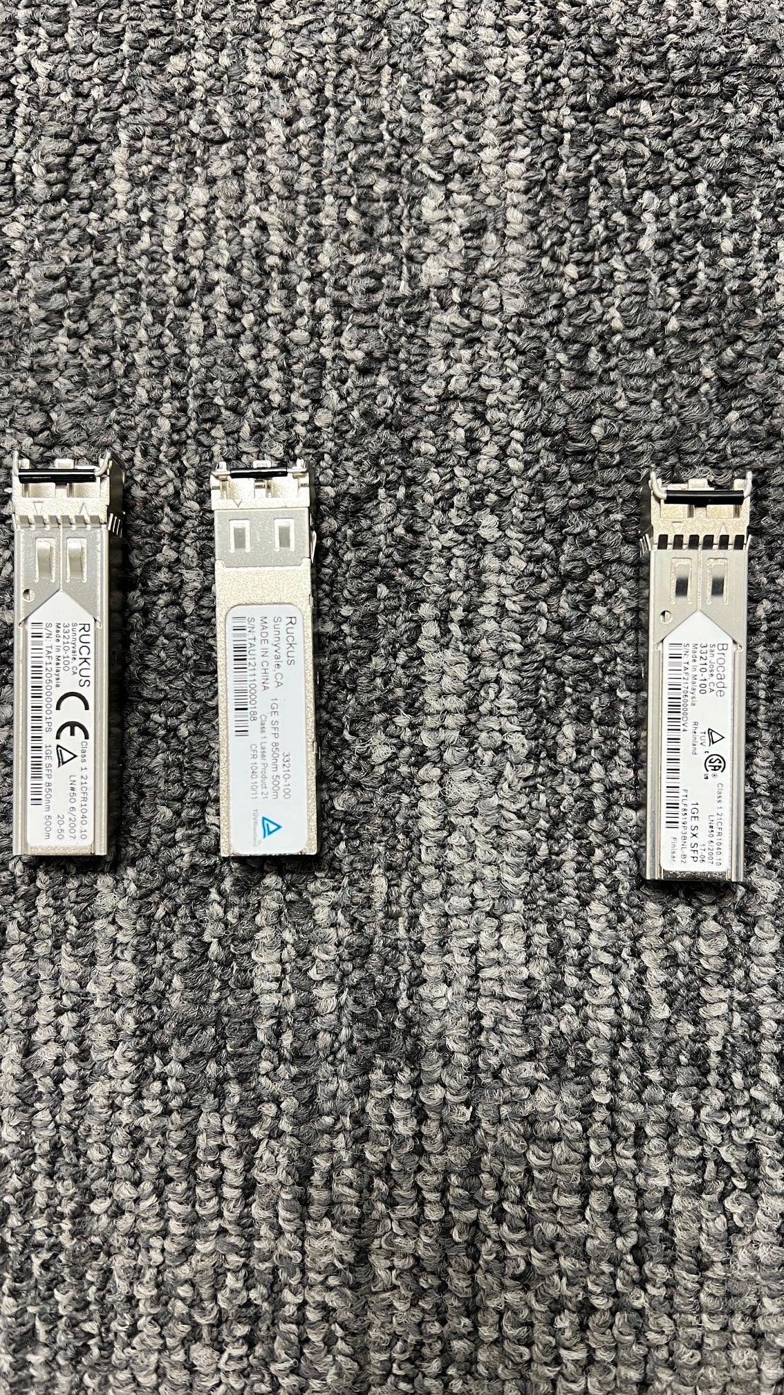

04-30-2024 10:41 PM
Hi @Donjb2007,
Thank you for reaching us.
Could you please share with us the screenshot of the label picture of the SFP on both sides?
Thanks
05-01-2024 06:46 AM
Hi Mayank,
see attached pictures in original post, above.
