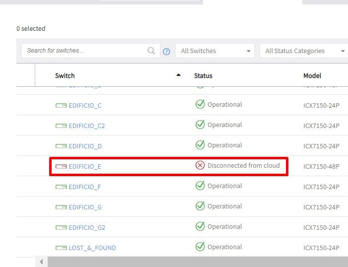

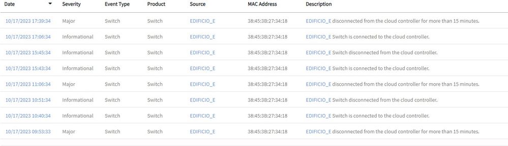

I have 12 ICX series switches deployed, but one of them disconnects from the cloud many times daily. It's the only one with this issue; the rest work excellently, If someone it has the same problem I'll grateful for your help.

Hey there. Have we done any troubleshooting to see if there is a problem in the path towards the cloud (internet) or an intermittent issue such as CPU spike? What code is this unit on? You can always open a support case (see my signature) and an engineer can help diagnose the issue.

Hi Carlos,
You can check the path from switch to cloud(internet) for any issues. If no suck issues observed then you need to capture below debug logs from the switch via console while the issue is happening.
debug destination console
· debug ip http client
· debug ip ssl
· debug ip tcp close
· debug ip tcp transactions
· debug ip tcp <cloud ip address>
· debug ip ssh
· dm http-ssl-tcp enable
fitrace modules sshm all level 0,1,2,3,4,5
fitrace modules socatm all level 0,1,2,3,4,5
Also, please collect below commands from switch and open a TAC case for with this information for further investigation.
- show manager logs
- show tech
Thanks
