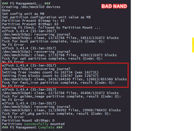

I have also noticed that this switch takes nearly 6 minutes to boot where as the same switch takes less than 2 minutes to boot.
I have went through the recovery process and it still lags and times out during this step in the boot process:

I even went as far as to do the golden image recovery followed by a complete reset and upgrade to the latest suggested version. Still noisy and very slow to boot.
This section of file system / partition checks seems to possibly point to bad NAND, the free inodes section again differs from another similar switch:
Please let me know if there is more that I can do to get this figured out.

I was able to perform a securewipe and that fixed up the issues with NAND, still a loud buzzing noise. I have two of the 8200-C08ZP models and they both buzz. The 8200-C08PF model is actually silent.
