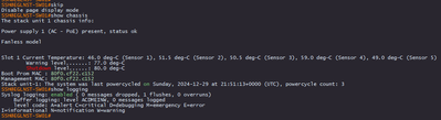

SSH@EGLNST-SW01#skip
Disable page display mode
SSH@EGLNST-SW01#show chassis
The stack unit 1 chassis info:
Power supply 1 (AC - PoE) present, status ok
Fanless model
Slot 1 Current Temperature: 46.0 deg-C (Sensor 1), 51.5 deg-C (Sensor 2), 50.5 deg-C (Sensor 3), 59.0 deg-C (Sensor 4), 49.0 deg-C (Sensor 5)
Warning level.......: 77.0 deg-C
Shutdown level......: 80.0 deg-C
Boot Prom MAC : 80f0.cf22.c152
Management MAC: 80f0.cf22.c152
Stack unit-1: The system was last powercycled on Sunday, 2024-12-29 at 21:51:13+0000 (UTC), powercycle count: 3
SSH@EGLNST-SW01#show logging
Syslog logging: enabled ( 0 messages dropped, 1 flushes, 0 overruns)
Buffer logging: level ACDMEINW, 0 messages logged
level code: A=alert C=critical D=debugging M=emergency E=error
I=informational N=notification W=warning
SSH@EGLNST-SW01#
  • I just upgraded to the latest suggested version: 10.0.10f_cd1
  • Currently NO amber LEDs visible on the front panel

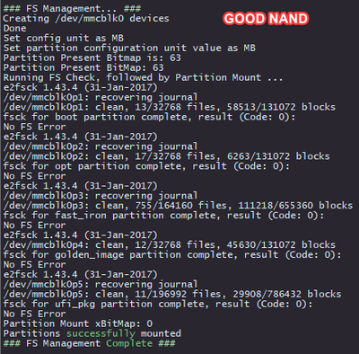

Here is output from a 08ZP model that appears fine with NO "setting free blocks / inodes":
