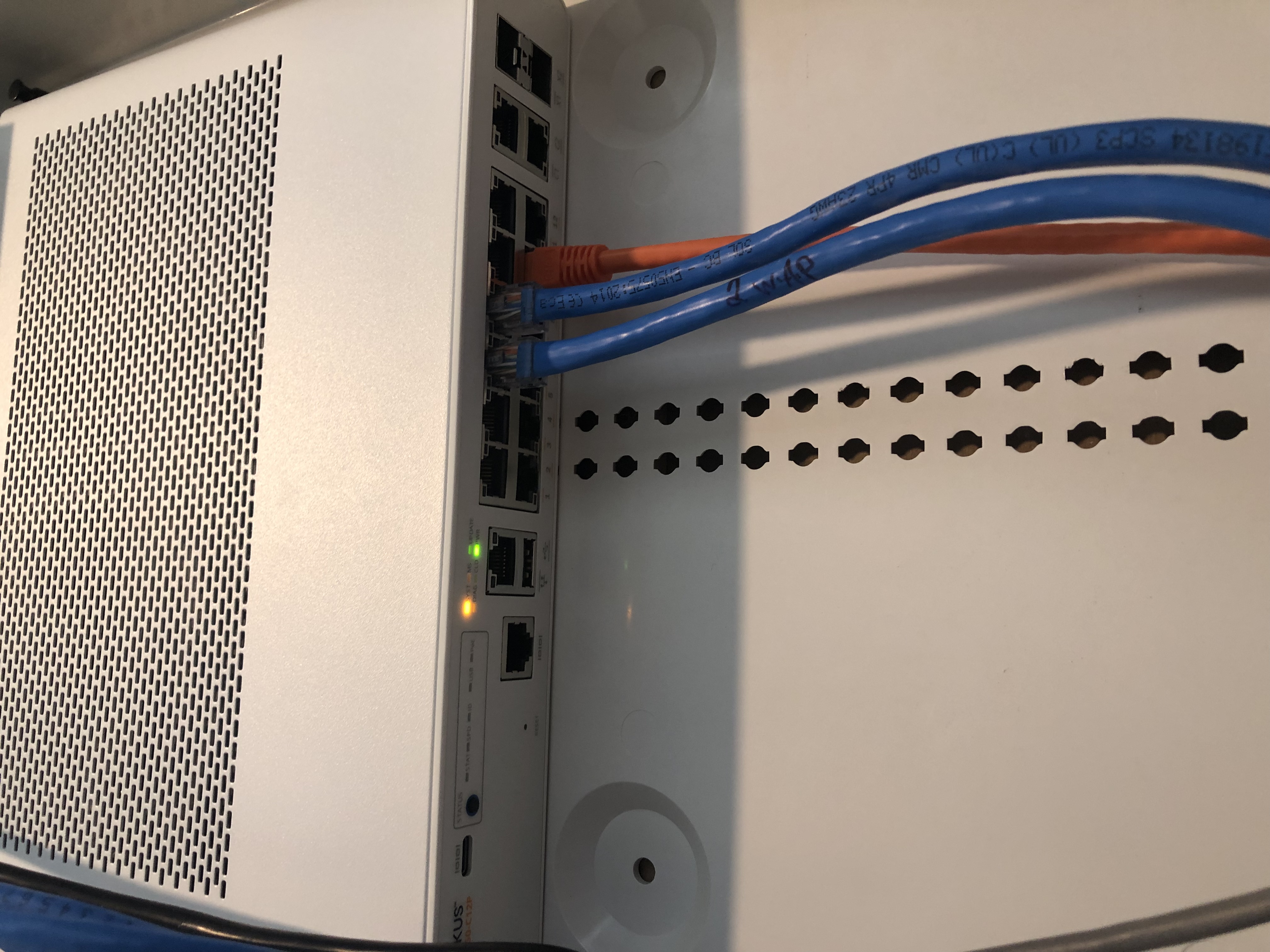

My APs are not receiving power (no lights present) after the ICX-7150-12CP switch was disconnected from power, the switch has two lights present (see attached picture). I read through similar posts on here and followed steps to console the switch with USB-C to USB, which I was able to do. I also followed steps to perform a software recovery but was unsuccessful as I received the following:

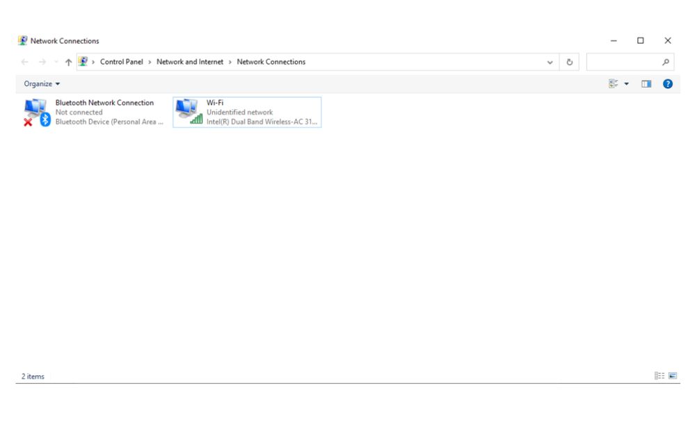

I am not sure if the error was due to not being connected with an Ethernet, the step in which I was required to input an IP address was to be done through an Ethernet properties (see step below), however, my laptop does not have an Ethernet port so I used the properties for the Bluetooth and WiFi (see attached pic). Since I received an error I am unsure what to do next.
Start>type control panel>View network status and Task>change adapter setting>Ethernet>right click properties>Internet Protocol (TCP/IPv4)>Select Use the following IP address>insert the same information I have>Click OK

I also notice that from the image you provided that the unit is having amber light . And When the SYS light is amber that means that the switch is stuck in boot mode.
I have a question for you here :
1> Did you try to boot the ICX 7150-12cp from primary and secondary image from service os .If not try to boot the primary or secondary partition like this: boot_primary or boot_secondary.

Thank you for the quick reply. In the response I was told to “make sure you have Ethernet cable connectivity from your ICX to laptop because here Wi-Fi and Bluetooth connectivity wont help”, however, as I stated in the initial post I stated I do not have an Ethernet post, how would I proceed in this instance?
03-19-2023 11:21 AM
Hi Ampersand,
There is no way , other than using ethernet port connectivity between laptop and ICX to Perform software recovery Hope that helps !
03-19-2023 11:32 AM
That does no make any sense to me as the instructions are also for a USB to USB-C cable.
