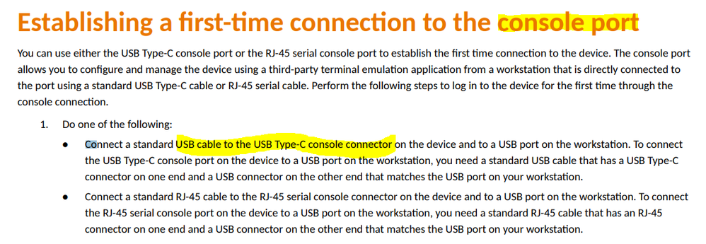

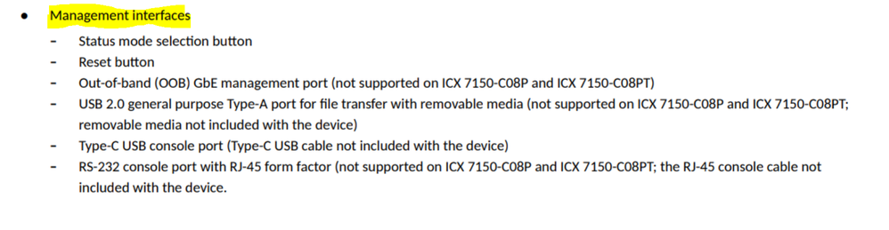

I understand that in the instructions there is mention of USB to USB-c cable but that is in context of console connection only i.e. management purpose as you can see in the below screen shots also .
But here we need a ethernet connectivity between the ICX and laptop because here we are not managing the ICX we are in the process of software recovery .
