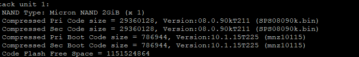

10-17-2025 04:11 AM
Hi Stobbertt
Thank you for reaching us
Based on the flash, the version appears to be 8090k, which may indicate a UFI format. Could you please help us confirm this by sharing the output of the "show version" command?

10-20-2025 03:00 AM
10-20-2025 07:29 AM
Hi Stobbertt
Thank you for sharing the details with us
Please re-flash the switch with the 8090k version once again. Once that’s successfully completed, verify if you see the image as UFI, then you can proceed with the upgrade to the latest 8095s version.
