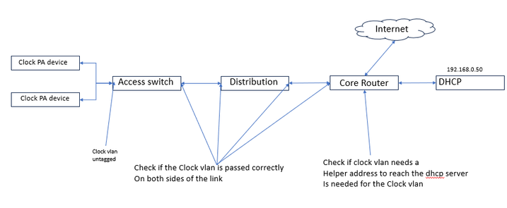

Adding to the above, considering that there are multiple vendors involved.
Hope the diagram helps.
