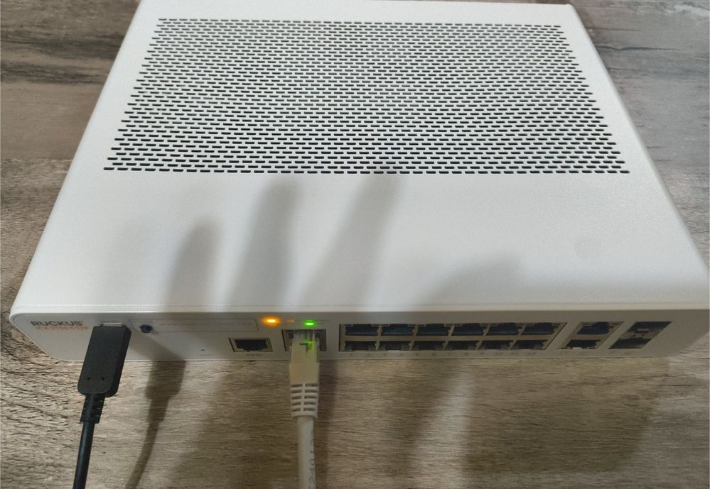

I have an ICX7150-C12P that isn’t booting properly. When I connect to it via the serial console, I get errors like:
  • "ZQ calibration error (P offset) - Manual IO programming required for correct operation"
  • "Validate Shmoo parameters stored in flash ..... failed!"
I’ve already tried a lot of things. I did a factory reset many times, definitely more than the 10–15 times suggested. I also tried pressing 'B' during boot to enter the boot prompt, but it didn't work. I can’t type any commands, so I can’t even attempt a firmware recovery.
I tested different cables too, including an RJ45 to RJ45 cable, and switched between a laptop running Windows and a Linux desktop, but nothing changed. Just to be sure, I also plugged it into different power outlets and tried different power cables, but that didn’t help either.
I'd like to know if it's fixable.

1 ACCEPTED SOLUTION
MariaC862
Hi!
Thank you for your post, based on the info shared it seems this unit is experiencing a boot failure, however, if we cannot enter any commands and non of the steps you have tried worked, then I think is time to consider an RMA.
Please contact our support team here: https://support.ruckuswireless.com/contact-us
Maria Cordoba
Sr. TSE | RICXI | RCNI
4 REPLIES 4
Imran_ruckus
Community Manager
Community Manager
Hi @LunarEcho72
Thank you for contacting the RUCKUS Community forums.
Could you please let me know if this is a Lennar Home RUCKUS setup?
Please confirm.
Thank you again.
I am sorry. This switch isn’t from a Lennar Home setup—I must have misunderstood. Since most of the info I found about the ICX7150-C12P pointed me here, I thought this was the right place to ask.
If this isn’t the right section, could you let me know where I should post instead? I’d appreciate any help with finding the right support channel. Thanks!
Hi @LunarEcho72
I have transferred your case to the ICX queue, where one of our engineers will be in touch with you shortly to assist further.
In the meantime, you may also submit a support ticket through the following link for additional assistance:
MariaC862
Hi!
Maria Cordoba
