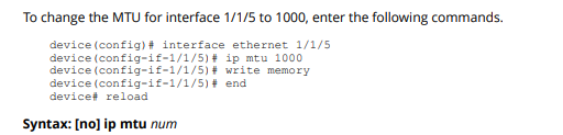

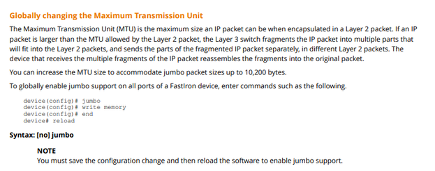

Below are few details I could find from "FastIron 08.0.30 Layer 3 Routing Configuration Guide".
I have mentioned the link below about the guide I referred and those are the only options available, refer Page 45,44 and 46 and Run through topic "Changing the MTU"
I hope this helps
Thanks
