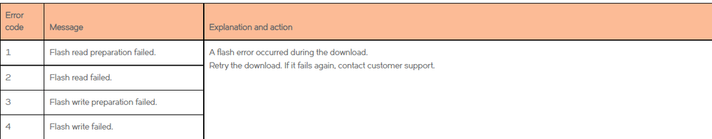

thanks ben , so I found the problem on TFTP blocking UDP traffic but now I have another problem
I can download config file from the switch to PC "TFTP" But cant upload config file from PC "TFTP" to switch , it giving me error code 1 . I looked up on Ruckus portal and not much details about error code 1
