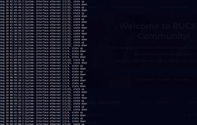

My company's switch logs show Down and Up statuses on the interfaces, even though the end devices are operational. We performed a firmware update to see if it would resolve the issue, but it didn't.

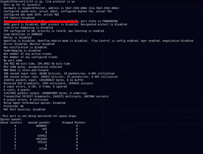

Further to the previous post, could you also provide details about the end device connected to this switch—particularly the ports that are exhibiting flapping behavior?
Based on the image, the port flaps appear to occur just seconds apart. To confirm whether the port is indeed flapping, you can check the interface uptime using the command: "show interface ethernet <port number>" and verify if you notice any CRC's or InErrors
