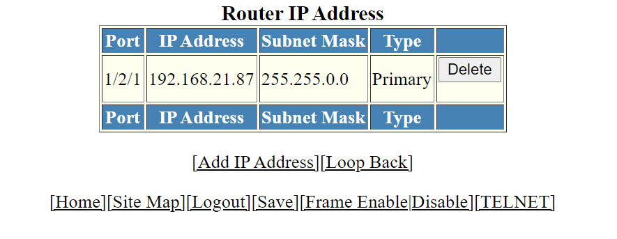

I'm having this very same issue and i cant for the life of me figure out why It's happening.  I have 1 out of 40 switches that's set up this way for reasons I can't understand.
I tried the following commands to no avail
 - interface management 1
 - ip address 10.22.3.44 255.255.255.0
I receive the following
Error: ip subnet overlap with another interface!
My working switches have an IP config that looks like this
Image_ images_messages_60f6fe947a94ac2b1e7ccd32_8490deb7f0e5e7bf5da3329aef0d29ac_Screenshot20210720125206-37e5a2eb-856e-4876-8430-9631b1f85268-1586964167.png

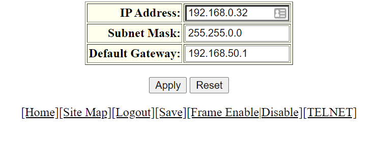

The switch that's giving me trouble looks like this
Image_ images_messages_60f6fe947a94ac2b1e7ccd32_f72c5746934e8be387dc8b163af62af9_Screenshot20210720125544-5ee27a51-2e2c-47c0-899e-c1a92ce5ba1a-67177476.png
michael_probert
This all started one day when none of the endpoints attached to this switch would respond.  I observed that I could see these devices if I was connected to this switch directly but not if I was connected to an upstream switch.  Since I had exhausted all of my troubleshooting options I chose to factory reset the switch (Not with the reset button because that doesn't work at all).
This is where I'm left.
I can access my switch using the IP address handed out by DHCP but as far as getting the correct IP, subnet, and gateway  assigned im completely stumped
