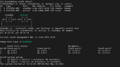

We do not allow stack ports to be named. With that said, you can decipher where they are going with 'show stack' and 'show stack detail'
As an example, you can see 1/3/1 is connected to 2/4/1. You can also see 1/4/1 is connected to 2/3/1. Hope this helps!

Thank you, that explains why I can't find it.  And yes, I am aware how to use "show stack detail" to get more information about what port, but I was looking for the ability to add our own free-form text description.
I am not sure why Ruckus would not allow those ports to be named, but if Ruckus will not do that perhaps the "Name" column can be removed from "show interfaces stack-port"?
No problem. 'show int stack-port' is really just 'show int brief', but only showing information on the stack ports and leaving the rest out.
