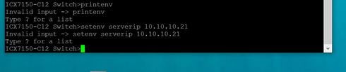

Hi Jijo - Im into the switch using my USB console cable and putty.  I looked up your instructions and they arent very clear.
the switch didn't like the commands printenv or setenv serverip 10.10.10.21
My device is the ICX7150-C12 switch.  I can enable it and get past the username and password such that the device name is displayed.  Please can you give me the exact scripts that I need to input from here in order to reset the switch.  Then I can simply cut and paste.

Let me clarify, The link shared tells you the recovery steps if your switch is stuck in boot prompt, I was assuming that was the case. From the above snippet your switch has booted up fine and you are in exec cli already so there is no need for it.
Are you trying to set the static IP address on the switch now ? Pls read thru the below guide (page 6-8) & setup accordingly.
