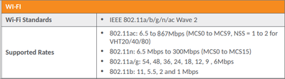

As per the R510 datasheet, max speed it can provide is upto 867Mbps (this is wireless speed, not your internet connection speed). Now since Wi-Fi work in half duplex (you can't send and receive at the same time) thus speed becomes half, 867/2=433.5Mbps. This is theoretical value, in practical speed can be lesser than that.
Now if you consider mesh connection, max speed will reduced by two. This is why you cannot go beyond this limit. For even higher throughput, use the AP with the ethernet connection or buy higher end APs which can support higher data rates.
