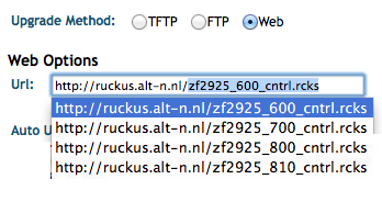

I'd think the 2825 is really a different device than the 2925, but you can give it a shot anyway. Try using one of these urls, see if it accepts it and upgrades, and remember to reboot after every reboot. Let me know how it goes.

You can also try to start with 500 or 420, see if it accepts it.

I meant reboot after every upgrade, of course...

Thank you! I have upgraded it to 8.1.1.0.12, rebooted and defaulted.
From log model is 2925 (see below).
The top line still 'Ruckus 2825 Multimedia Wireless Router' - this is not a big deal,
There is still no wlan configuration, and I see "Port Forwarding" instead of it - this is a problem!
