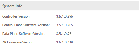

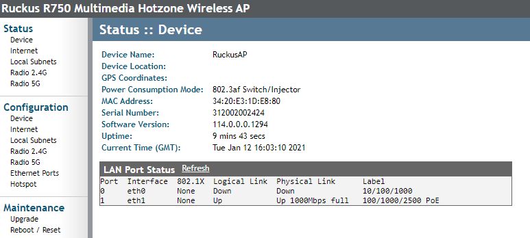

We need some help from you.Actually ,we have  a problem with our Ruckus AP R 750 that we can't add to the Smartzone 100.

Hi Mobio,
R750 is not supported on 3.5.1 version.
Please upgrade the controller and then AP zone to at least 5.1.2 version.

You will need to update the firmware on your SmartZone controller in order to provide support for newer APs.
The earliest version of SmartZone to support the R750 model is 5.1.1. - with a special AP software update bundle applied.
Please consult the release notes on the Ruckus Support Website to understand what steps you will need to take in order to upgrade your SmartZone to the desired level, as you will most likely need to upgrade in multiple steps.  The latest SmartZone version is currently 5.2.1. with AP patch 1038. This is the recommended version for Wi-Fi 6 APs.
VirtualSmartZone Software Updates: https://support.ruckuswireless.com/software?filter=83#sort=relevancy&f:@commonproducts=[vSCG]
R750: https://support.ruckuswireless.com/software?filter=174#sort=relevancy&f:@commonproducts=[R750]
Please ensure your existing APs are compatible with any new version of software you install and you may need to run multiple Zones as SmartZone has the ability to run different firmware in different zones.
