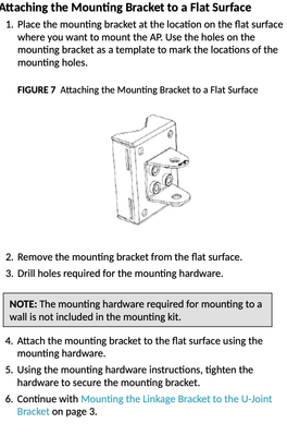

Is there a way to wall mount a T710? If possible, I’d like the back of the AP to sit as close to the surface of the wall as possible. Right now, I can only find a way to mount it to a pole or maybe an extension arm.

Many thanks for looping me in @syamantakomer !
It is possible to wall-mount the T7x0/T6x0 series APs using the bracket that's provided.  One of the components can be mounted to a pole or a wall.
Check out the Quick Start Guide for further details.  I've attached an excerpt showing the details.
Additionally I believe it's possible to mount the AP bracket directly to the wall-mount bracket, without the arm/extension piece.
I hope that helps!
