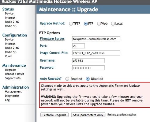

I'm trying to upgrade my 2 standalone 7363 AP and I'm not able to do it
One is running code 9.0.0.0.80 and the other one 8.2.2.0.7.
I don't have the local choice as you can see here : http://img62.imageshack.us/img62/8262...
Of course TFTP, FTP and HTTP when I try them.
I have the latest BL7 code 9.6.1.0.15 . Is there a way to have the right url or the file ?

And the FTP is working now as well. See screenshot of a successful setup
Image_ images_messages_5f91c408135b77e2479280a3_9eca842befd2ddd80a1668b7dcf1f49b_control_file_inline-c223a9be-394a-4d30-9657-a2c2a691ef4a-594513342.jpeg1382389637

steven_michiels
Thanks. This worked for me.
However when entering the weblink to the image gave me a error while updating.
Something like "control file is bad".
I then rebooted the AP and i noticed the firmware was updated. After that i could use the local option to upload the latest firmware.
Best regards.
