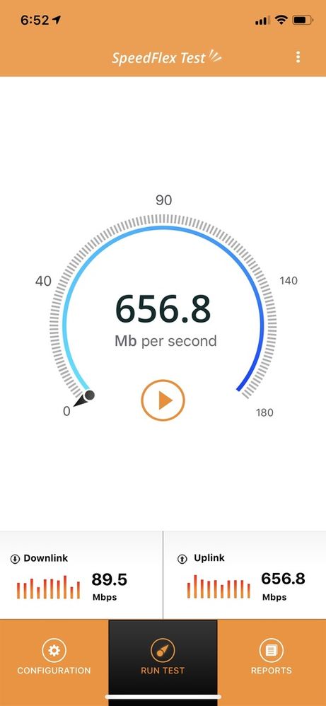

Strange issue with R710 on latest unleashed firmware. Upload speeds consistently incredible on both laptop and phone but downloads even from 5 ft away never go over 200 but stay consistent through 3 thick walls. Speedflex on android shows 550 up 550 down to AP. Iperf reflects speedtest.net results. Cable shouldn't be the problem as I have plugged my laptop on it and gotten the gigabit fiber speeds I should be getting. I have factory reset it countless times set everything to auto and tried manually setting the bands and channel width, am I missing something? Any help would be appreciated.Image_ images_messages_5f91c3fe135b77e24790df97_43e5db9b2eca36b81d35b46dbdb8f876_RackMultipart20190818868831y92-dc568500-96c2-4610-9714-84fb1bdd684c-743324385.jpg1566155318

This is on IOS. Windows laptops average 500/500
Image_ images_messages_5f91c458135b77e247a361c3_84b64d32ec67bfd360432e4703ad4753_RackMultipart20190820582231ai7-06d59c33-b394-41ac-94f6-4b7c6378a765-1445385585.jpg1566266066
