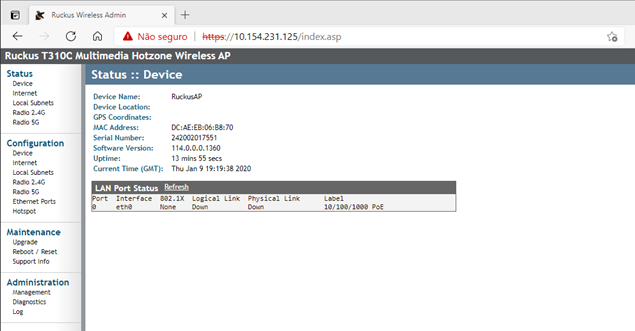

03-29-2021 07:39 AM
Hello Karthik,
Thanks for the reply.
I have tried your suggestion but it seems it goes to the Standalone configuration page:
Should I do a firmware upgrade or something like this in order to get the ruckus with the Unleashed software?
03-31-2021 07:39 PM
Hi David,
Yes. You are right. To use in Unleashed mode, Firmware change is required. Version 114.x is used for solo/controller/cloud deployments. For Unleashed, 200.x series firmware is required.
