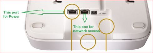

That means APs 1st eth port is providing power and second providing network access as shows in the below image? If yes, try SSH into the AP and run below commands.
Image_ images_messages_5f91c498135b77e247b04188_846604abc2c22dfe8d9777ca6d574597_RackMultipart2019112975462nbh4-788f0274-5800-45fd-bdf1-0078d072866c-2126143479.JPG1575030630
get eth
Example output"
>get eth
Port  Interface  802.1X  Logical Link  Physical Link      Label
0     eth0       None    Up            Up 1000Mbps full   10/100/1000 PoE
    eth1       None    Up            Up 10Mbps full     10/100/1000

rkscli: get eth
1     eth1       None    Up            Up 1000Mbps full   10/100/1000
OK
This shows that both the interfaces are working fine.
You may try to switch the cables and see if that makes any difference.
