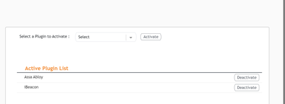

I found this link mentioned the plugins name but I didn't find assa abloy:
https://docs.commscope.com/bundle/iot-2.0.0.0-configurationguide/page/GUID-9C186AEC-DAB4-485A-88F3-F...
Hi @Mohammadsaeed
You should be able to see the AA in plugins list as below :
Note : Once the plugin has been enabled it will not show again in the list until deactivated/deleted.
