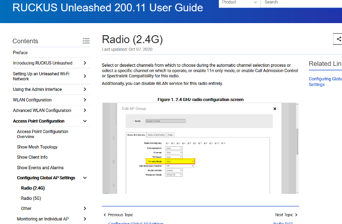

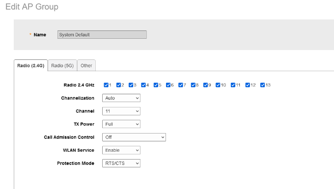

Hi Guys,
iam running a mesh with 3 R510 AP with Unleashed Firmware 200.11.10.5.195.
There should be an AP-Group Option for configuring 11n only Mode.
But there is no such Option. This one is missing.
Image_ images_messages_61ec58064ad08869ee0087d1_2a428a8bf2036378be744d140acf674f_2022012220_11_29Window-3f70605f-a15f-4b2a-89ce-27113e78a0a4-1633034033.png
What did i wrong? Why there is no Option as described in Online help?

Yeah, that is annoying.  Every now and then Ruckus decides to remove or hide functionality that might confuse the 2% of users who are inexperienced while complicating life for the other 98%.  They also removed proxy-arp at some point.  You can disable 11b by enabling OFDM mode on each WLAN.  If you have more than one wlan, the commands should be executed for each wlan.  Here is an example to enable OFDM only mode on two wlans - "Blue1" and "Blue2"
