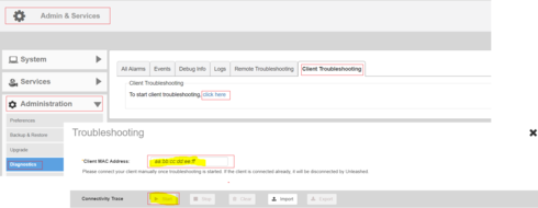

Hi John,
If some devices are getting IPs and some are not, please use the Unleashed inbuilt utility called Client Troubleshooting.
Image_ images_messages_5f91c482135b77e247ac6250_7dfbf99b9915951f1b650e9877aa7e43_RackMultipart202008317308l3zd9-81f04dad-5fa3-4f57-97a0-236b7433ff38-420068993.png1598888385
This will help you to find at what point it is failing.
