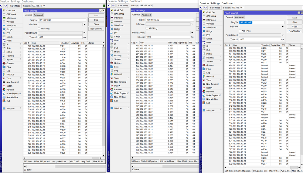

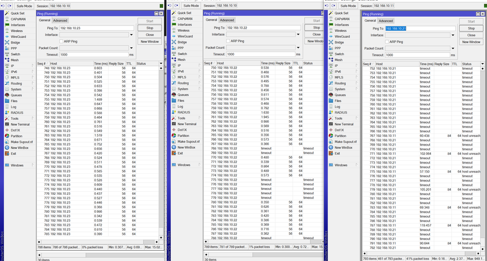

There are three R500 points in the network. Connected to Mikrotik POE. There is a short-term dump of one of the points (2-4 packages). If you turn it off, this problem appears on the second point. If you disable the second point, the problem appears on the third point.

Andriy
New Contributor III
