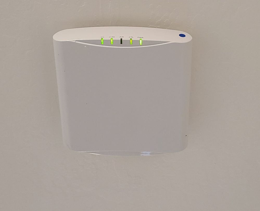

I am unable to connect to my Ruckas AP as of today. Everything has been working fine for a long time.
I am able to connect directly to my Cox modem both hard wired and wirelessly.
After a number of reboots and restarts, I'm getting the same results. The 4 lights on my AP are solid green.
When I try to connect to my Lennar network wirelessly, I either get "connection failed" or "connected without internet"

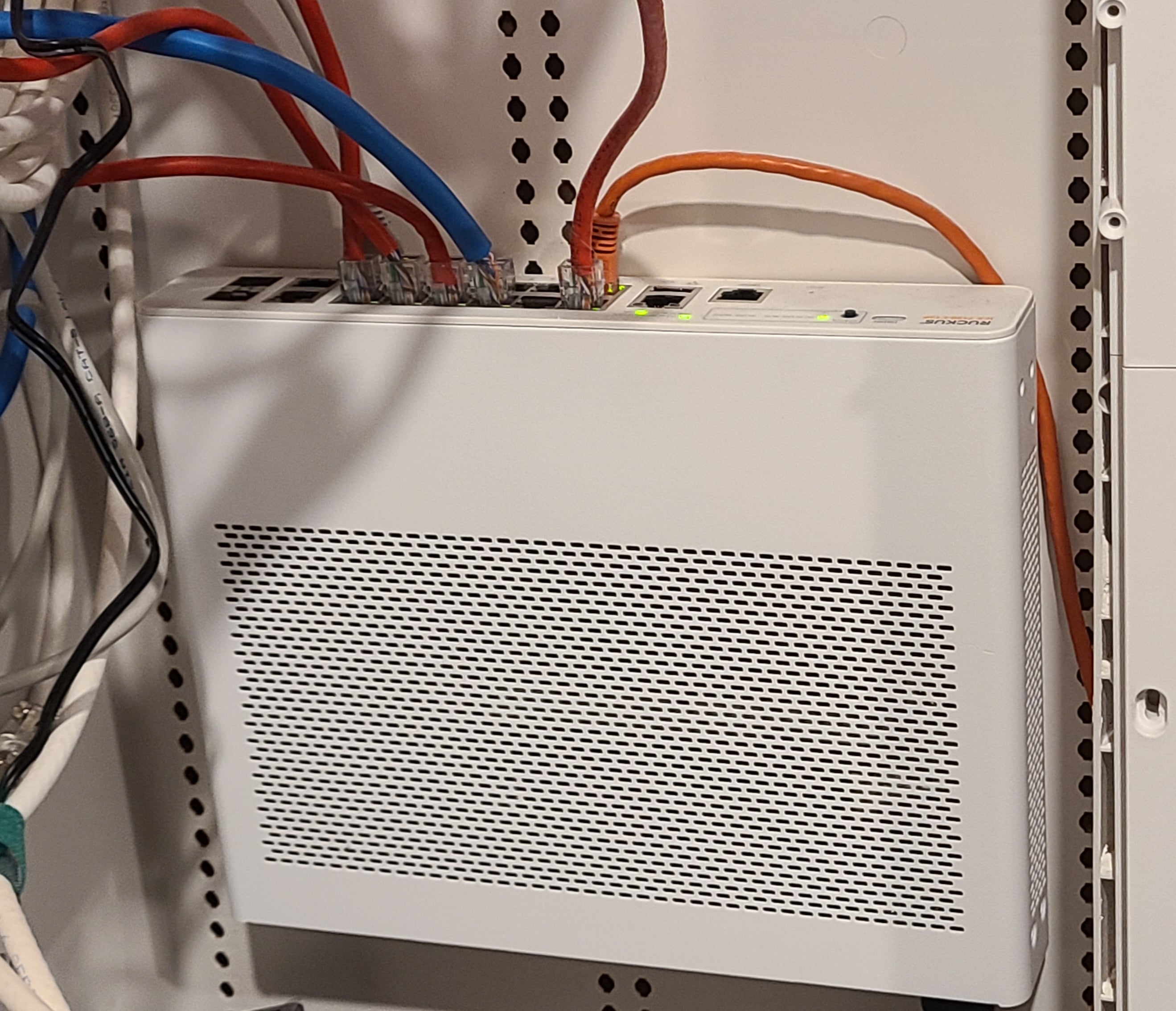

Here are photos of my switch and AP.
Any suggestions on how to get things working again are much appreciated.
Thanks,

From the pictures you shared, it seems that the cable connections look normal.
Before we can help, we need to check few configurations on the Switch and which version the Switch is currently running.
1. To check this, we must identify the ‘current’ IP address assigned by your local router to the switch ICX-7150-C12P
ICX7150-C12 Router> OR
ICX7150-C12 Switch>
show version
show flash
show inline power
show interface brief
lldp neighbors detail
