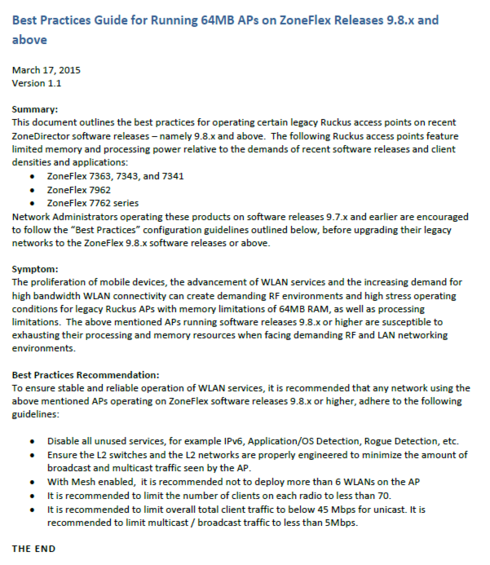

Would like to upgrade Zonedirector 3000 to 9.8 to add newer AP models but still wan to support older APs, mostly 7762s. What does this mean: "Early models of Ruckus APs have 64mb RAM that may limit performance running 9.8+ firmware"?
How/where is the performance issue (does it affect individual APs, ie slow network speed or is it a system-wide thing - limit on users/WLANs etc. thanks

The article says the below information:
64mb AP Performance Considerations 7962 7762 7363 7343 7341
Summary : Early models of Ruckus APs have 64mb RAM that may limit performance running 9.8+ firmware.
Question : What considerations are necessary with 64mb APs in current firmware?
Customer Environment : Customers who still employ 64mb RAM APs: 7962, 7762, 7363, 7343, 7341 after 9.7 release
Root Cause : More capable and feature rich firmware has higher requirements on AP processing, and older model APs with 64mb need to be limited for best results.
Troubleshooting Steps : View ZoneDirector Monitor/Access Points page which lists AP Model type.
Resolution : Disabling non important services and reducing the number and type of WLAN serviced is recommended.
See the attached 64mb AP Performance Considerations document for further details.
