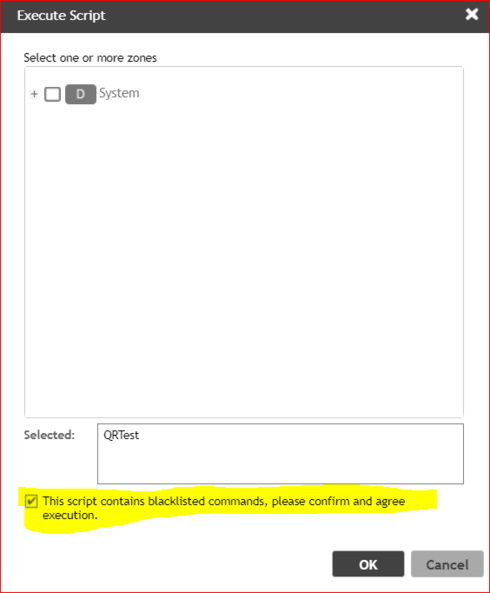

Not sure how much labbing you really need to do, when the product itself tells you it will do it. Image_ images_messages_5f91c47b135b77e247ab163f_de8a4446919cecd36e795a363cb8f354_RackMultipart202005144813272j2-f674db86-2df5-48cb-8980-5d9f0b87ed1a-1202930150.png1589481380

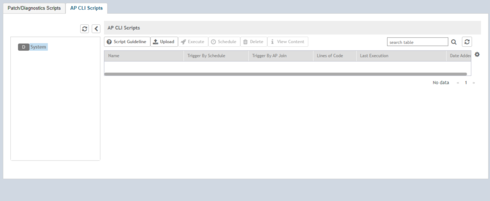

Hi there,
Thank you for your suggestion. However, I don't know why in my web ui, I don't see the check box. I can't even upload my script to SZ.
It's just blank like this. I'm running version 5.1.0.0.496. Can  you advice? Thank you.
Image_ images_messages_5f91c47b135b77e247ab2444_08e4a7dcd50432ff87c3a5bce67747ff_RackMultipart2020051558318og4a-6aa434f1-1f93-4386-ac60-4b0651cbca39-226224286.PNG1589504434

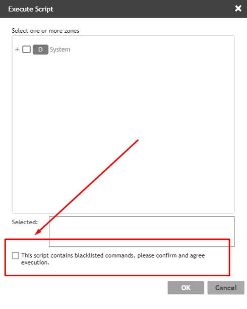

It seems you did not uploaded any scripts yet.
1- Please upload the script with reboot command
2- Select the uploaded script
3- Click on "Execute" and there you will get the "Checkbox".
If you try to schedule a reboot script then you will not get the checkbox but it will let you schedule it. I haven't observed yet if scheduling a reboot script works but will test and update.
