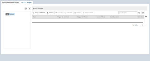

Thank you for your suggestion. However, I don't know why in my web ui, I don't see the check box. I can't even upload my script to SZ.
It's just blank like this. I'm running version 5.1.0.0.496. Can you advice? Thank you.

It seems you did not uploaded any scripts yet.
1- Please upload the script with reboot command
2- Select the uploaded script
3- Click on "Execute" and there you will get the "Checkbox".
If you try to schedule a reboot script then you will not get the checkbox but it will let you schedule it. I haven't observed yet if scheduling a reboot script works but will test and update.

It does work to schedule it. You don't get the checkbox but it does work, we use it every morning to reboot our APs until the patch comes out.

Thanks for your all response. Could you tell me which version you are using? Because in my case, when I try uploading a script contain reboot command, SZ prevented me immediately. A pop up comes up and say that I cannot upload that script.
