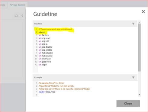

I am not sure which version you are referring but command will not work.
Below are the command which are Blacklisted in 5.x version and above.
Image_ images_messages_5f91c499135b77e247b07a22_4b5132049084c3b8f9ccb7ce2d6233bf_RackMultipart20200514651679x1w-07f1de4c-5299-4eff-a988-d84da3a1969f-952346748.png1589479285

They WILL work, I have tested it myself. If you upload a script with the reboot command in it, the system will prompt you with a checkbox in order for you to continue. Basically you are agreeing that while it's a blacklisted command, you still want to proceed. Test it yourself.
Could you specify on which version you have tested it.

I've tested it on 5.1 and currently being used DAILY on 5.2.
Thanks for the details, I will test in lab setup.
