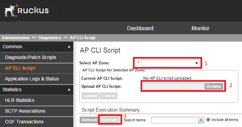

providing all the AP's are in the same Zone you can accomplish this using a KSP script:
Then go to the Administration >> Diagnostics >> AP CLI Script:
Other than that you can extract all the MAC addresses to a csv file and then add the following line to a column infront of the MAC address and then copy, paste, right click in the CLI of the SZ:
fw_version=3.1.1.0.474Just save the above script to a file with a file extension of .ksp
model=all
reboot now
