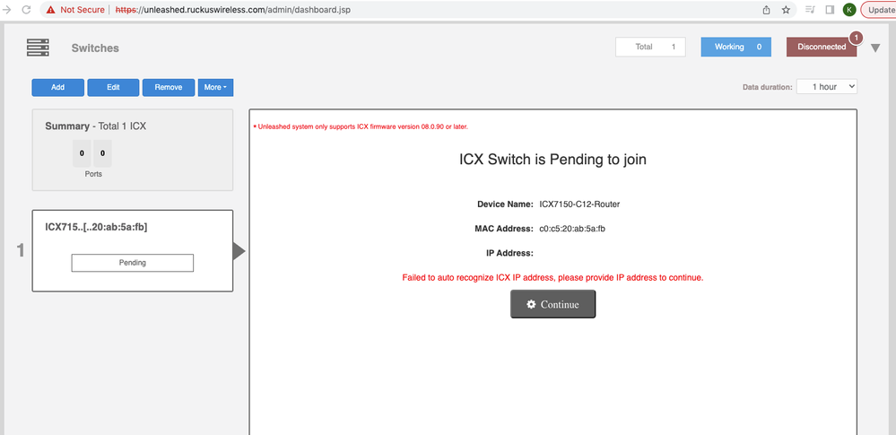

Hello,
I also see this in unleased dashboard. Please find the attachment. So I tried to follow this guide on my mac - https://community.ruckuswireless.com/t5/RUCKUS-Support-for-Lennar-Homes/How-to-console-in-the-ICX-71.... But not able to see /dev/cu.SiLabs_Serial under /dev. Can you please help?
the requests are timing out some time and some times they work:

05-02-2023 03:43 PM
Forgot to attache this in earlier post.
