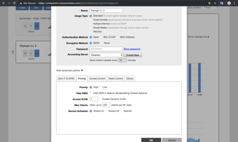

I have tried editing on the Access point menu (like the attached picture) but it's still the same.
Please help me 😞

After edit setting :
Image_ images_messages_5f91c3f7135b77e2479007d1_c501747a9b3a86d455f400ff5f0b0b8e_RackMultipart2019061229921a742-790de93b-880e-4417-94fa-b0d4673455f6-1750183424.png1560320234

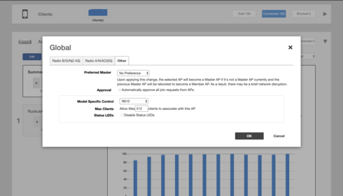

If you were adjust max client to 512 under Global >Other > Max cliients, you were correctly done.
That's Max number on the AP.
And you did set 100+ in WLAN setting, you have to see it connected 100+ client on the APs.
Example : If you did set 100 in WLAN setting, Max clients are 110 on 2.4Ghz and 110 on 5Ghz; total is 220 client on APs because you did set 512 under Global >Other > Max cliients.

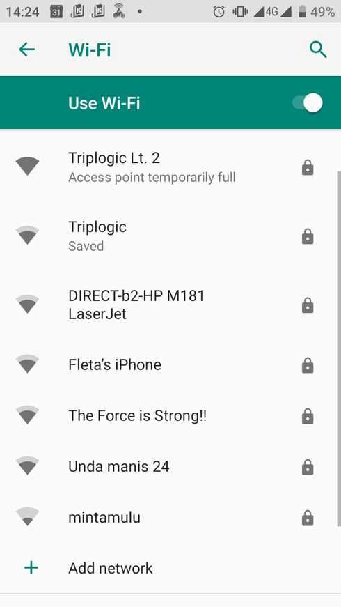

I have done what you informed me, but when the device goes to 101, it cannot connect with the notification "Temporarily Full Access Point".

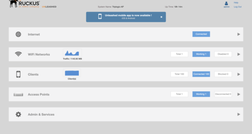

This is my Ruckus R610 setting.
Please help me 😞
