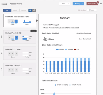

So, the first problem, that actaully may solve most of the headache: How do I upgrade the units to the latest firmware!? For the last 4 hours I have been able to update 2 of the R310's to version 200.7.10.202.141 (yes, it's taken that insanely long time, because more often than not the upgrade halted, the session closed (is there any way to stop that behavior!?), there was an error, the IP's didn't match, Reboots of the system one zillion times, etc etc…).

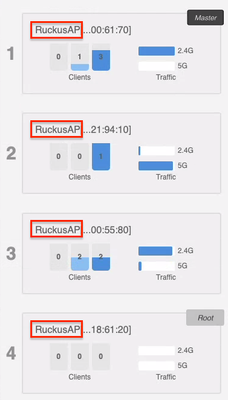

As I write this I see this dialogue (btw, this is the first time I see 4 AP's in the list):
It has been on 40% for ten minutes now. Should I wat more? How long?

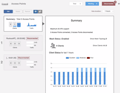

Before this, I did a restart of the system, and then it looked like this:
 Some of these units switch IP's (or possibly MAC addresses) between restarts, which is extremely disturbing, and I don't have any explanation for that.

  • Is there any way to name the AP's? Instead of remembering the MAC addresses I would prefer a more human name like "Hallway 1" (I mean the names marked in the screenshot). This way I could give them normal names, if I also am able to identify them when I'm there. Thus, it would be much easier to solve connection issues like the ones described above.

For naming the APs, you can select the AP >> Click on Edit >> And then give the name under "Device Name"
