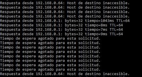

Hi , I have a problem with new equipment AP R710 and R510, these are connected to port of switch POE and to laptop y when turn on, viewing command respond ping command, but, do not are responding after two o four answers correct, then cannot connect to console for configure the APImage_ images_messages_5f91c3f5135b77e2478fa413_a3b55a8d1de6a4032b6816293af86f56_RackMultipart2018112232309zu52-811e5486-6fbd-4a4e-88dd-df17b918eb4e-1933828187.JPG1542847552, ¿canyou helpme?

===>  Try to connect this AP in the place of a working AP and check if it is working fine.
===>  Remove the AP from the network and Power on using adapter / PoE switch. Perform a hard reset by pressing the hard reset button for 20 seconds (AP must be powered on).
===>  Try to connect the AP to the Laptop and ping the AP on the default IP 192.168.0.1 and make sure the laptop IP address is also in 192.168.0.x range.
If this does not help and still there are PING drops, please reach out us at below-mentioned numbers.

We met same issue many many times.
You have to RMA at this issue.
You have no method to solve because Ruckus ap don't have console port.

I've had this same issue when changing the APs IP. Just stops responding. Here's what I did and started working every time:
*Factory reset the AP by holding down the reset button for 15 seconds (ZoneFlex APs need to be powered on).
*Plug into your ZD and wait for it to be added.
*Do not add it to the VLAN yet...
*Open a command prompt and do a continuous "ping x.x.x.x (your IP) -t" You'll get lots of responses.
*Open another command prompt and continously ping the IP you want it to be.
*Change the IP. You'll see the first window stop responding, and then in a minute the second one will. You won't see the AP in the ZD for a few minutes. But you know it's there because the ping is successful. Just be patient. Sometimes it takes 5 minutes or so for it to show up in the console. https://appsync.biz/dafont/ , https://downloader.vip/mapquest/ , https://appsync.biz/filehippo/
*If you're going to put it on a VLAN, after it shows up in the ZD you can add it to the VLAN for connectivity.
